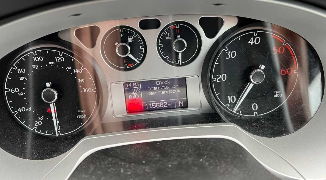

I have found one nearby that has problems and the owner wants too much for a dead car, otherwise I might have taken a punt.
I have tried to help him out, but by now I probably know only enough to be dangerous.
He has a transmission not available after first having intermittent problems with the 'box. I have posted a screenshot he sent me.
