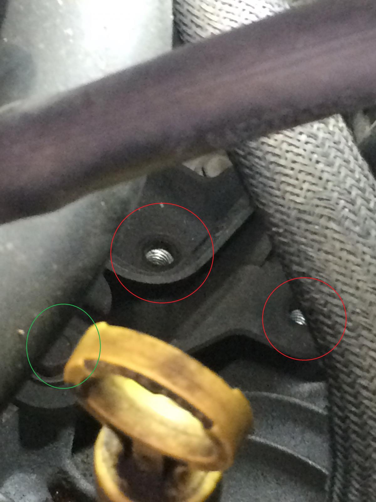

    Anyway I find out why my engine is rocking when I turn it off or start.
My gearbox dieed back in January in Belgium, and I had it repaired by the "Re-Engineered Transmissions" from Essex charged me £1600
And this is why - becouse they decided that ONE bolt on the box bracket will do the job!!!  :angry:
Had to stop puting things together and need to find two bolts tomorow to go there.
Can any one help me and tell me the spec of them?  Please... need car for monday!

Missing Gearbox bracket bolts Update : I found the fellow 40miles away that brakes one. So hopefully will put everything back together and the engine will stop rocking.
In terms of the job that was carried by Re-enginering Transmition from Essex, it is still under waranty but I'm not going there (100miles) just to pu two bolts. Dont know what to do about them, I paid them £1600 for the job and this is unaceptable. Any recomendations in order how to get compensation from them?
