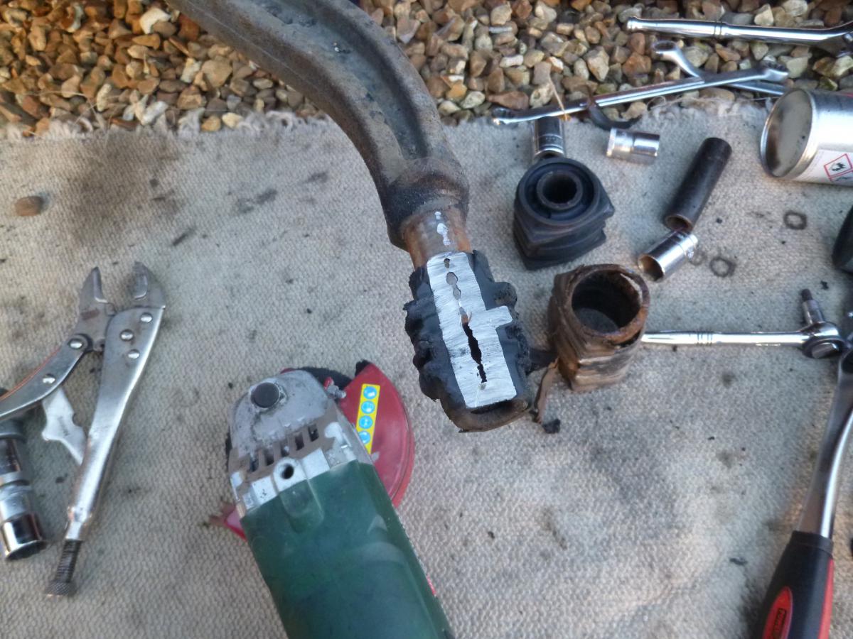

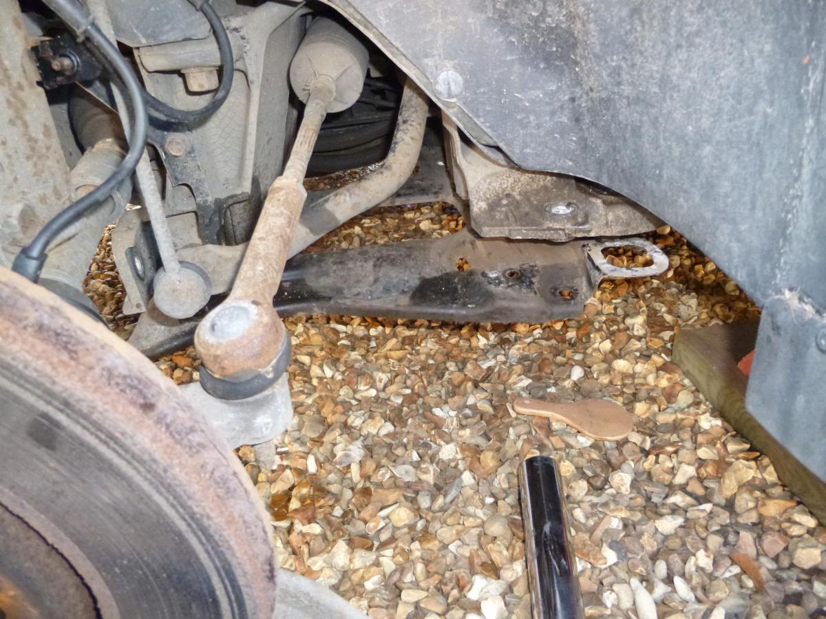

Well as expected it failed the MoT on the rear bush, so I followed the guide above and it went well until I tried to separate the bottom plate from the Aluminium chassis section. With all the bolts removed including the long one which goes through the big rubber spacer and holds the whole lot onto the car that rubber spacer/bush won't come apart !!!.
With the main bolt out you can lever a 70mm square top-hat plate out leaving a 70mm square rubber spacer/bush, but the bottom plate won't pull over it, and it doesn't seem to let me separate it off the Alloy sub chassis.
I could perhaps pry/cut the bush off, but without stripping the whole front suspension out, I can't see how a new bush could be fitted in its place ?
Anyone else been stuck with this
Okay, carried on and prised out the Bush, it had to come out one way or another, and with that out the sub frame was lowered and the Arm came out.
Old Bush off, new one on, well on once I spent a long time cleaning the inside of it out of over-rubberisation (note to self - do not but cheap eBay replacement parts), and now all back together   :).
