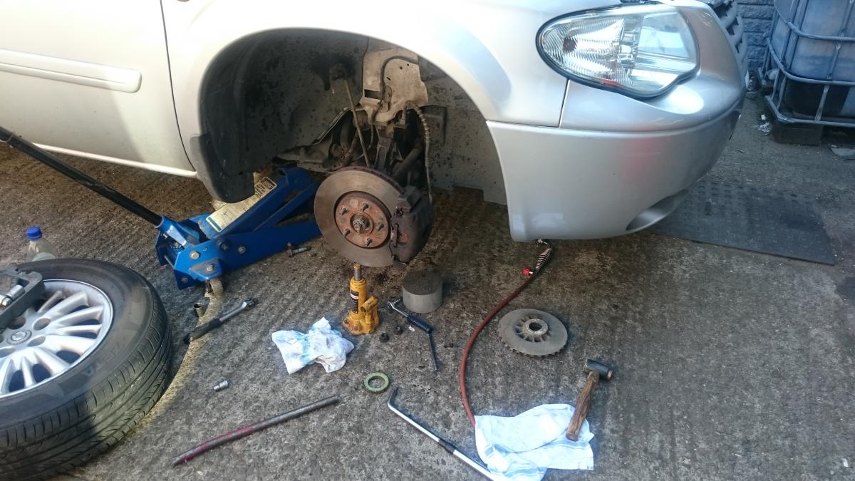

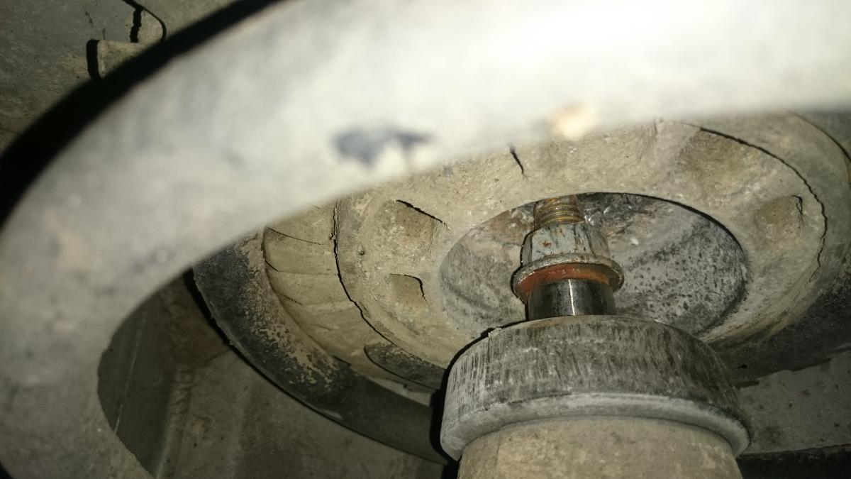

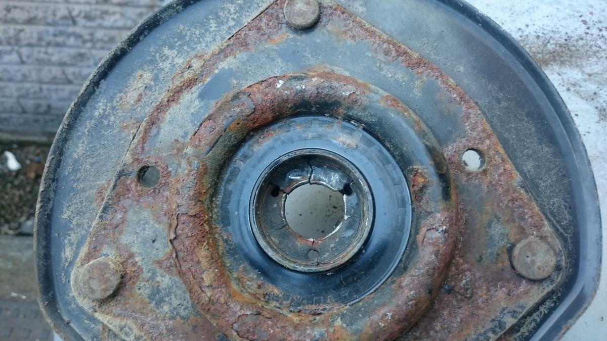

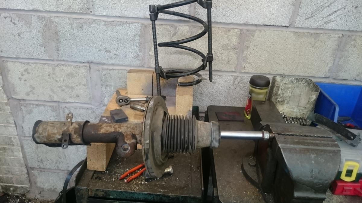

Hi all I had the offside top suspension mount giveaway yesterday. Blimey does it knock when driving. Anyway got to work today only to find shock absorber wasn't attached at top lol. Oops. Anyway £38 and 2hrs later all fixed. But was not easy as spring was on full expand.so anyone thinking of doing there's good luck.trying to compress spring while on care so it could be removed. More luck than anything else. I'll try and download a few pics
