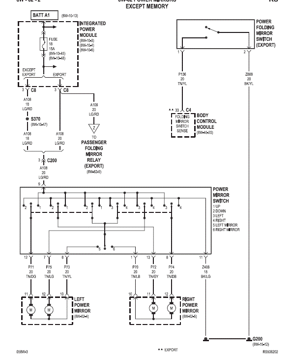

My first is the electric mirrors, neither side works. The power fold works perfectly I just can’t adjust them, is there a fuse or relay? I’ve tried looking it up but can’t seem to find the right answer.

Assuming this is a late registered Mk 4, there is only one relay feeding the mirrors(according to the workpoo manual (no did not spell it wrong), if it's a Mk 5 then don't know.
Possibility the switch is at fault. Tried to upload an image from the manual but 18.iKb doesn't permit !

Ther is no relay for the mirrors only a fuse (No. 18.. 15A

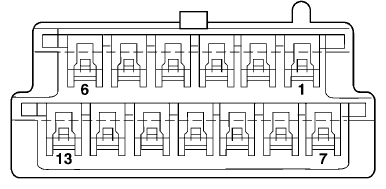

SWITCH CONNECTOR
12 Volts Ground MIRROR REACTION
    Right Left
PIN 12 PIN 6   UP
PIN 7 PIN 6   Left
Pin6 Pin 12   Down
Pin 6 Pin 7   Right
PIN 13 Pin 1 Up
Pin8 Pin 1 Left
PIN 1 Pin 13 Down
PIN 1 Pin 8 Right
refer to Mirror connector switch image attached - Using two jumper wires:
Connect one to a 12-volt source
 Connect the other to a good body ground
 Refer to the Mirror Test Chart for wire hookups at the switch connector
another answer follows with switch wirig details
