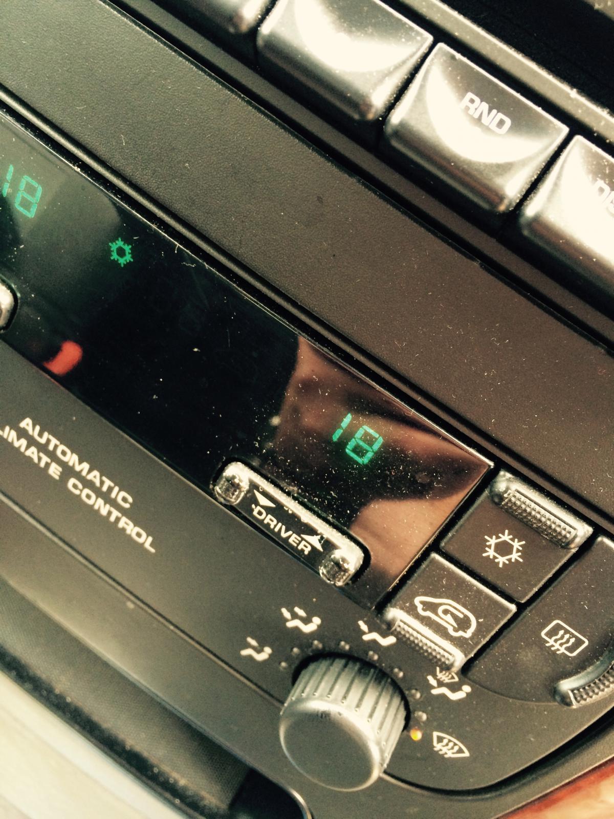

Air Con - On All The Time !
karmannski
If the selector is on windscreen, as it is on your photo, or foot + windscreen, the system will switch the AC on as it thinks you want to demist the screen.
Turn it further round to say face and foot vents, and it should click out the AC.
If it all goes off when you turn the climate power off then all's good. But there is another problem that occasionally occurs. The fan auto speed reg packs up so the fan is on full with no control, and when you switch off the fan stays on full and goes into recirc mode.
