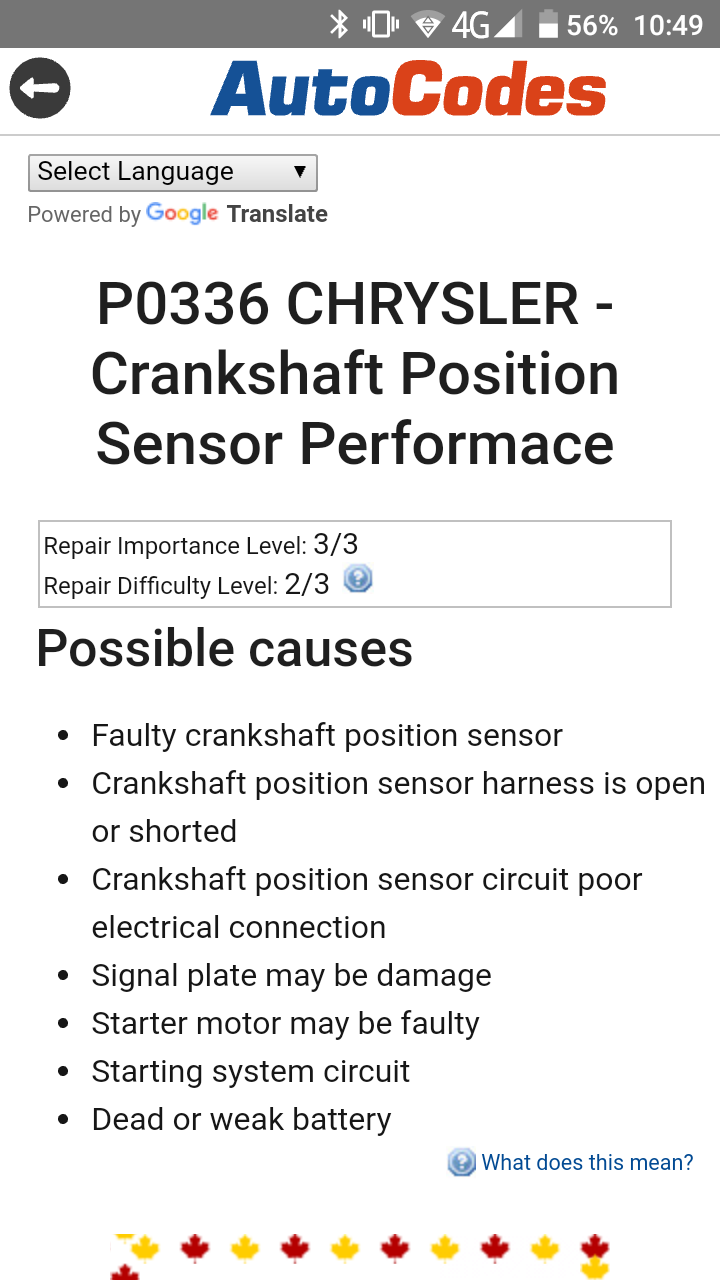

Hi, have you checked the wires to the CKP.
Download Autocodes app and you will get details of the fault.
On my autodata to test it says with plug disconnected, you should have 886ohms at component.
Another test that I do is:
Removing the glow plugs, ignition on, turn the engine by the crankshaft with meter probes connected in parallel to the sensor, you should get an intermittent reading ohms and/or voltage( I'm not sure what the measurements are) but it shod fluctuate.
Hope it helps.
