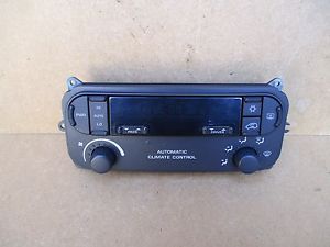

There isn't a lot to change/set on it the climate control to be honest, I'm assuming you have the climate control like this one:
In which case you use PASS and DRIVER up/down to set the temperature (Temperature will be shown in either oC or oF depending on if you have set yours for metric or imperial displays - this is set by your overhead console control).
Hi or Lo sets the automatic fan speed, Lo restricts the max speed to somewhere around half way, Hi lets it use full range.
Pwr - full climate control on/off overall control
Fan and direction dials are self-explanatory and yellow led shows current position.
On the right you have ice icon indicating manual on/off of the air con pump/condenser, Recirculate on/off and finally demist.
All the settings have a related onscreen indicator.
When you first set off, if conditions are very cold you'll see "Delay" followed by a number on screen, this is the system waiting until engine temperature is warm enough to start the fans, otherwise it'll be blowing freezing air at you (You can override by just changing the fan/direction and it'll ignore the delay and give you control).
