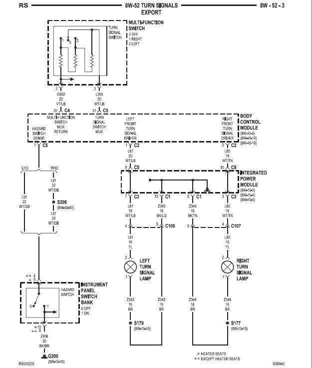

  1. Anyone come across chrysler GV 2007 indicator/hazard lights flashing on dash but nothing outside at bulbs.
    Changed fuse box , body control module, indicator switch and cleaned the earths , you can hear the little relay in the dash when the display lights flash on and off, any one had this before. I’ve tried all the earths but all seem ok
    thanks

      All I can suggest (going by what you report above) is to check voltage starting at BCM (2,4) Hazard appears to # 1
      BCM 2 -> IPM 5->IPM7->(attached jpg may help if you don't have manual)
