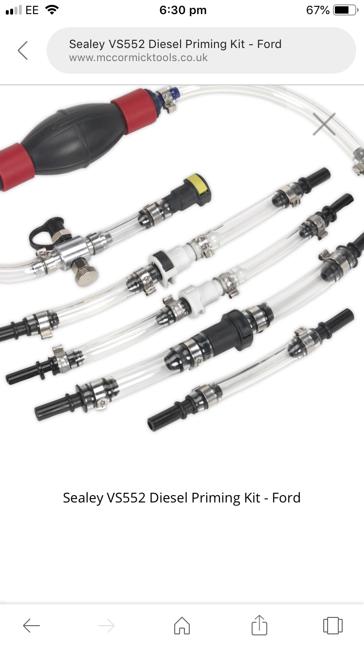

On vehicles that do not have a electric submerged intank primer pumps , the main hp pump has a vaccum section built on to it , best way to check for air ingress is to 'clear pipe it up ' you break into the lines at the hp pump ... feed and return ...it is then possible to see the fuel flow and which way any air bubbles are migrating rather than randomly guessing at parts like i see on all owners forums .....have this mantra ...."what if i fit part X and it does not fix it then what ?? Test not guess .....everything is testable...you just have to have the knowledge how to and the correct kit .....if you do not have the correct kit then it just boils down to 'guess a part' till the customer runs out if money like i see nearly every day at work
