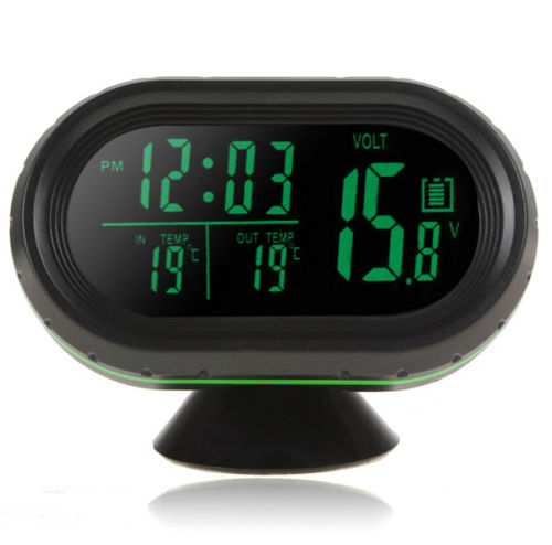

This is what I use to check voltage:
When engine is not running, it shows current battery voltage. (useful to check how worn is battery)
When engine is running, it shows the current voltage, the alternator is charging the battery.
I fitted this on the far left side of the windscreen, so one look and I can see.

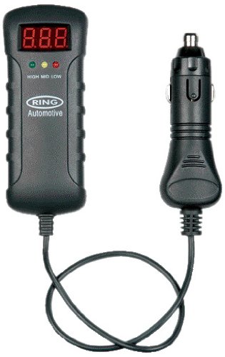

- get one of these for your RHS [not left] cigarette lighter socket, not very accurate but a good indication of 'live average data' while driving

Get one of these, put it on your old battery and leave it switched on forever and ever. 80% of batteries we scrap & replace are actually still good just 'sulfed', we scrap them by the million but they are mostly ok. Battery manufacturers worlwide rub their hands together, melt them down, then sell us back our own expensive lead as 'grey lead' % in new lead batteries. This charger will even repair sulphated batteries.

I will stop reading my voltage lol. I have ordered the ring intelligent charger, but can not find the voltage display you also showed me, Where would I find one of these?? got some 22k resistors on order too, As soon as I get everything I need will post back with my findings so you can fathom them out for me lol. I really appreciate the help you are giving me too as it was starting to met on my nerves a little, We will get there in the end!
