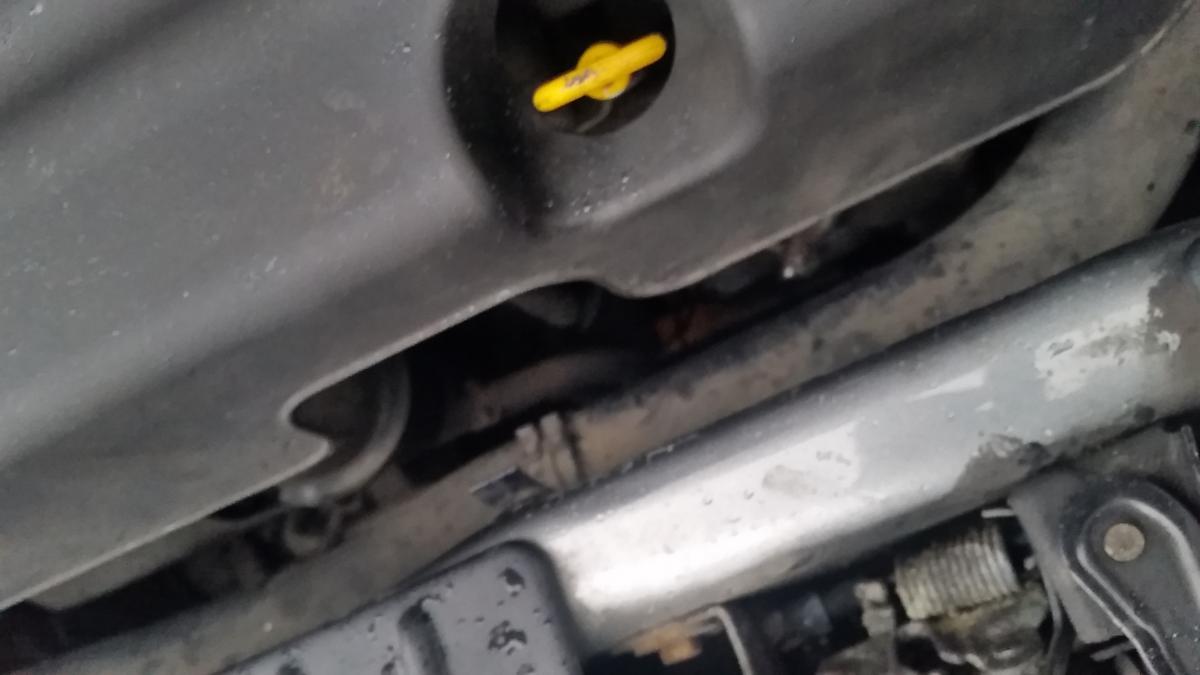

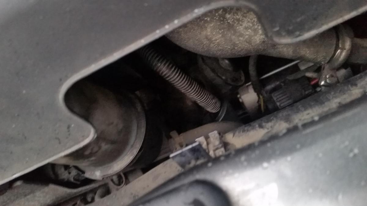

I think I have found where problem is. Will know for sure tomorrow. One of the cables connecting alternator was very loose. Had to push it in quite a bit. Once connected, starter operates much quicker. Next thing I will need to check is fuel filter. Fuel starvation
yes. looks like loos cable was the issue. car started ok today. now i need to get fuel filter done. i've checked youtube and internet, but cannot locate filter near fuel tank, the only one i was able to spot was in the engine bay near radiator. ive got 4th generation gv from late 2005. do you guys know if it is the only fuel filter?
