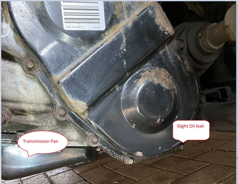

PS:  On the side of the gear box above the pan there is a cover.  At the bottom of that which is level with tiop of the pan, I can see a very very small amount of oil but I would not call that a leak.  I wonder if this gear box had burned or leaked more oil than I took out???

I think I can see the problem.  I kept adding more oil and eventually after 6.5 litres total, I have enough in there and I can see oil on dipstick.  There is a cover on the side of the transmission which is just above the pan.  The bottom of the cover is just flush with the pan and I can see a very small leak. I cannot see it dripping as I cleaned it yesterday and it is moist with oil in one spot.  Obviously there was a leak and previous owner ignored it.  It probably was running on low oil for a while and I hope there is no damage.
I cannot see a gasket so I try to remove and use RTV gasket to put it back on.

Here is the photo of the leak section:

Well I turned the wheel to get access and just tightened the bottom 3 nuts by very tiny amount.  I did not want to shear off or squeeze the gasket underneath any more.
You can actually see a metal bracket to provide more strength or protection on the bottom 3 nuts and that is where the leak is.
I cleaned with grease cleaner and brake clean.  I went for a good 25 minute drive and also kept it running for another 10 minutes.  It is as dry as I like to see.
I will keep checking for the next few days.  If it leaks then it is the case of getting that cover off 10-12 bolts + Clean + RTV back on to be real sure.  (Already ordered Permatex Black RTV Gasket Maker)
