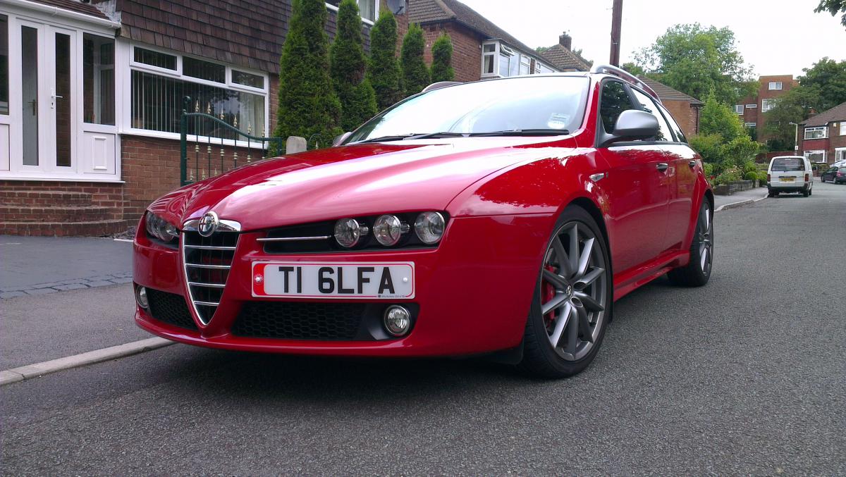

You had a TBi sport wagon! Awesome! How was the boot space compared to the delta? I am still tempted to buy one but it’s crazy money for a car 5–6 years older than my delta and double the mileage. I loved my 156 but it always has some niggles which I don’t miss especially with a family to transport about.
Very similar to be honest as the stupidly high boot lip is always a restricting factor. Yeah the TBI is very rare as your know especially in SW format... It was one of the last on a 60 plate, so was a phase 3 with the black half leather/alcantara and red piped seats with black aluminium dash. Great engine with almost V6 like performance, just quite muted in the audible department.
