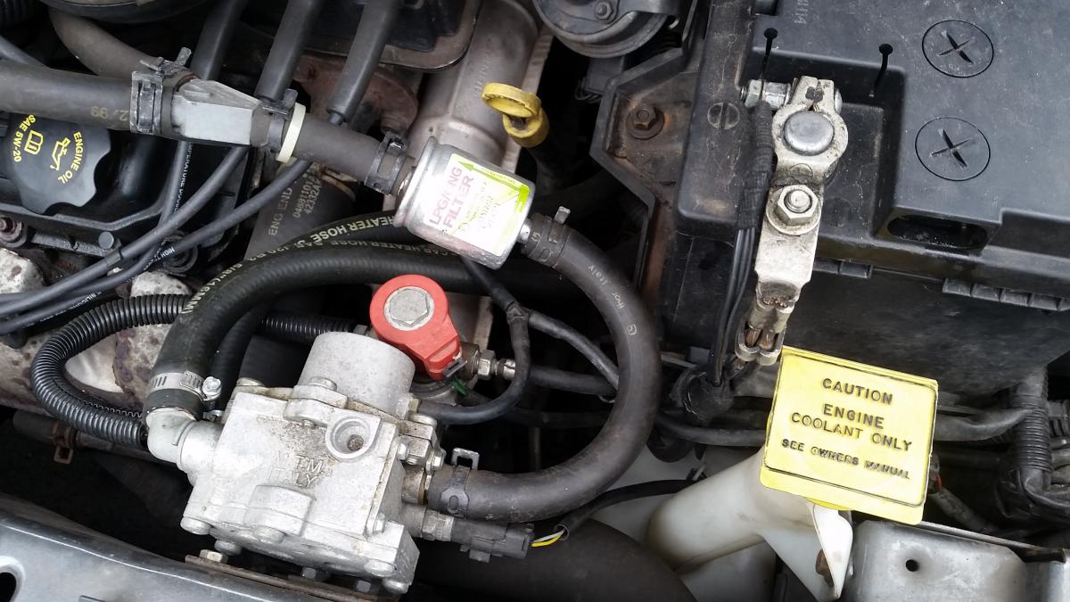

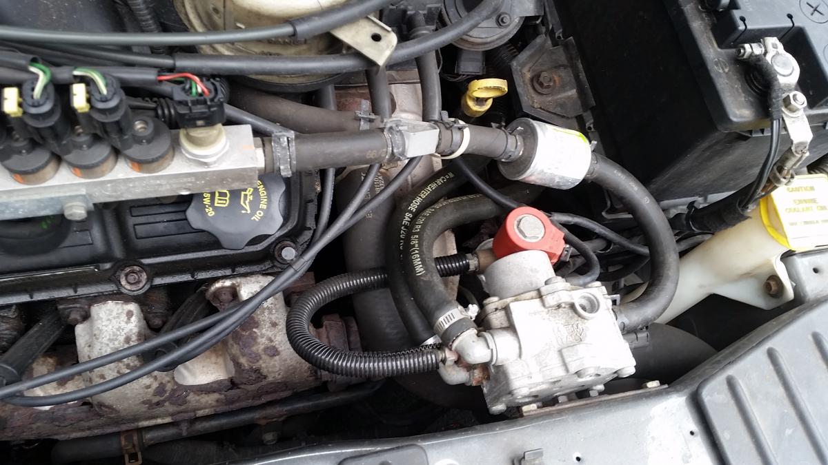

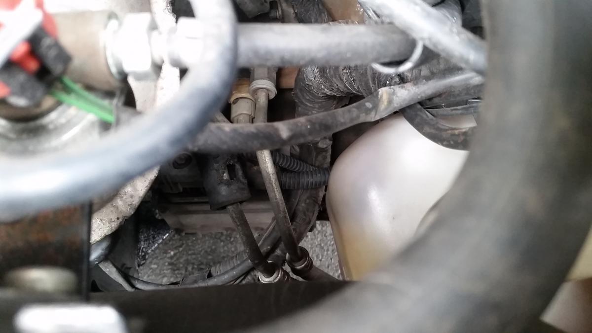

@@Daz264  I did mine a couple of years ago, quite awkward on my V6 petrol as the front bank exhaust runs round that way, and I have some LPG kit above it to, but I think I remember taking the battery off on mine for a bit more access, can't recommend it though as I seem to have read recently some wonderful things happen if the battery is off or dead for a while. Mine has so far been ok on that front, so far.......
Most time consuming thing I had was cleaning up the face for the new gasket!
You won't have to do the fluid, especially as you you say above it's been done recently. It seem to be above the fluid line.
