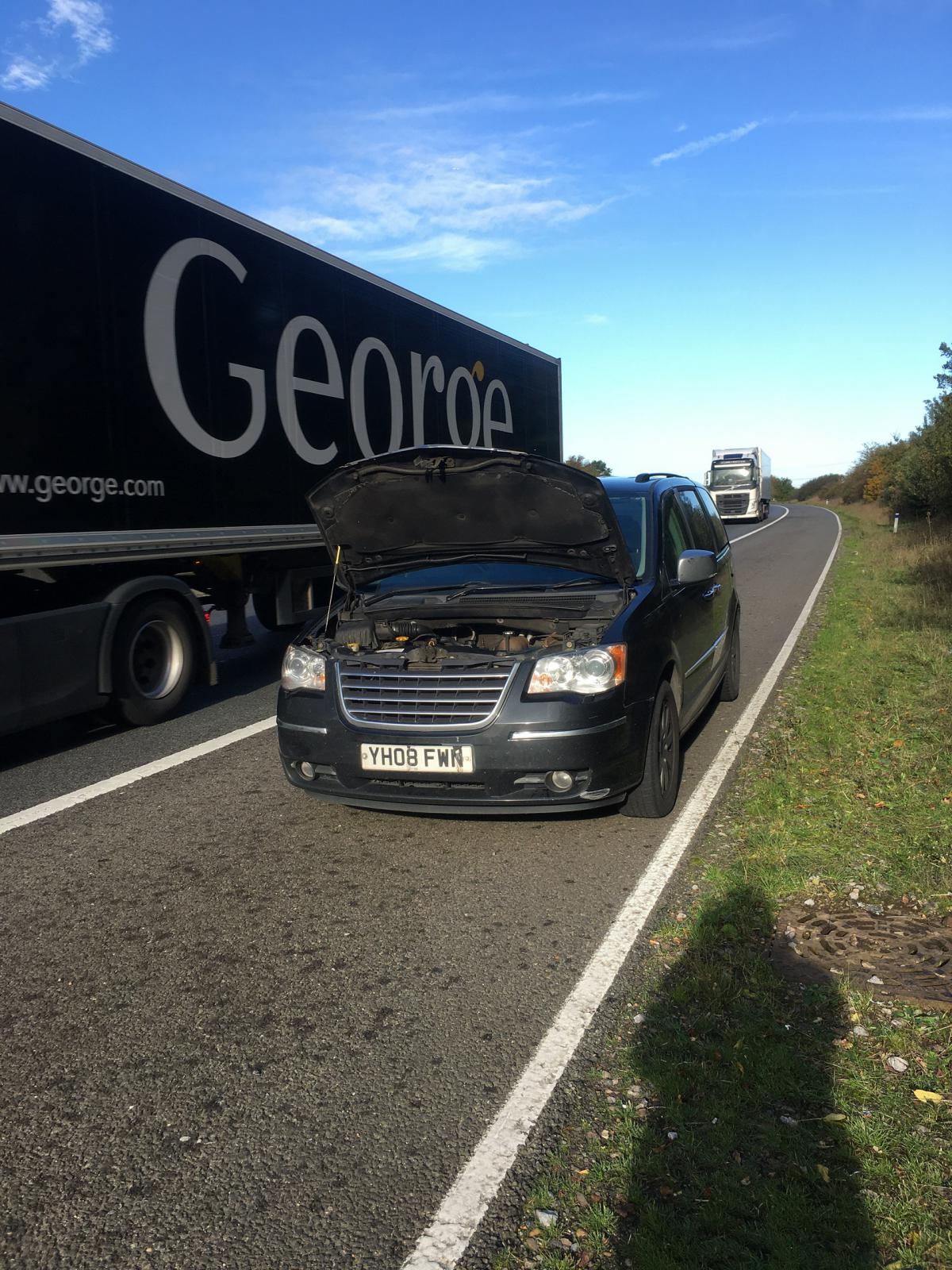

Greetings to all fellow grand voyager owners,as in earlier post i had problems with 62te gearbox the car was stalling at times when comming to full stop and after changing box oil and filter didn't improve this i just gave up as that didn't cause much problems anyway,but yesterday(6 months later) while cruising on m11 i suddenly lost all gears,narrowly escaping lorry behind me managed to roll on hard shoulder.
