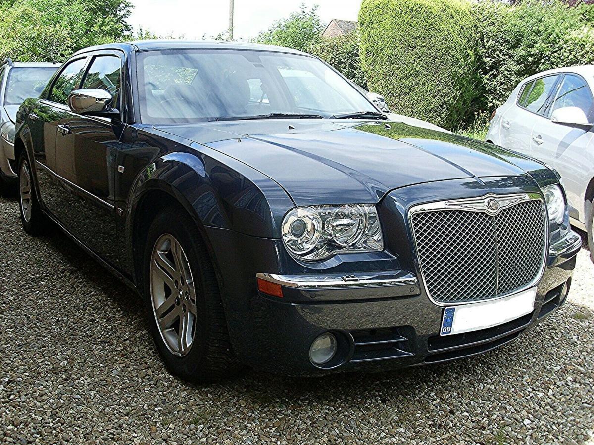

I have looked all over my lovely 300c for the paint code colour but alas cannot find it.
It is a dark blue metallic (almost a gun metal blue/grey) colour (SEE ATTACHED PICTURE)
I need it to buy some touch up paint for chips and scratches etc.
Also where to buy this would help too please.
Thanks in advance
Dave
Hi, the paint code will be located on the underside of the drivers door, look where it says PNT and it will have the paint code. Failing that take your car to a car paint supplier and they can get an exact colour match and make you a can up, if the cars not driveable take the fuel filler cap to the shop and they will get a match off that
