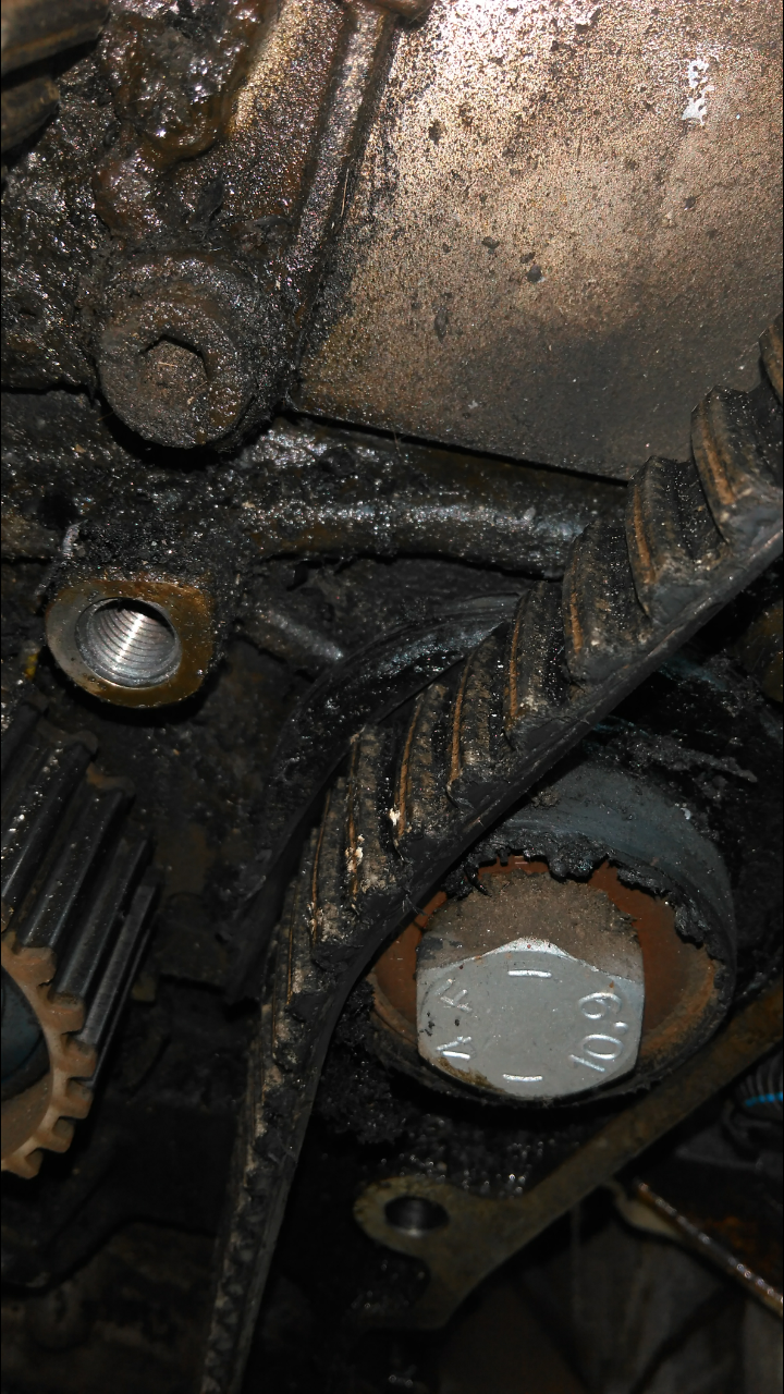

Well found the problem absolutely mental it still ran glad I switched off when I did! Anyone ever seen this happen before most likely all original. Any guides on changing I'm confident at doing anything regularly work on cars only issue i have is I don't have a locking kit.
Turned out idler was melted in bits, waterpump was completely seized and belt was split and melted I have to say what luck I had iv replaced everything and been for good blast an hour ago and she's a different car! Took me 8 hours but not bad for first attempt lol thanks for info guys will be looking at a remap soon.

No the idler is behind the lower metal cover no signs of it rubbing etc iv got pics of the scrap got to see them to believe it! What an engine lol.

It's been a week now no issues since replacing I had an INA kit including metal pump. Everyone who's seen the state on the old belt and bits are gob smacked lol. Changed all boost pipes to silicone (orange). Looking to upgrade few things any recommendations?
