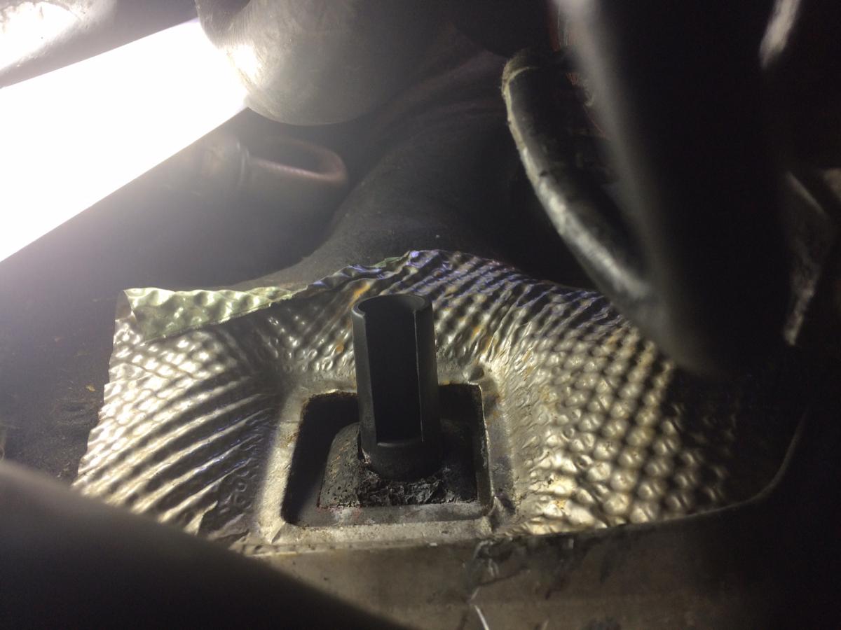

Looking underneath with the engine running, above the turbo, but below the thermostat there is a 2" plastic pipe with an odd "U" shaped channel in it, sticking out thru a heat shield in the bulkhead.
The water is coming out of this pipe at a rate of 1 liter for every 2 kms.

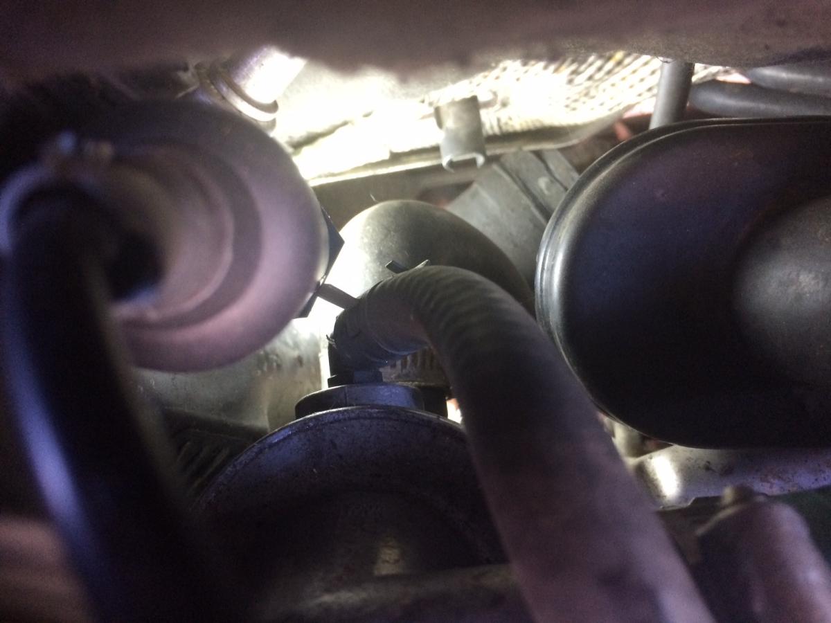

I have attached a view from the top and from the bottom.
The pipe in question is sticking out of the bulkhead surrounded by a heat shield.
It has a "U" profile that can clearly be seen.
It is near the water pump, underneath the Thermostat Housing and above the Inlet Pipe to the Turbo (to take photo from underneath I removed the Turbo Inlet Hose.
Be aware this damn pipe only leaks AFTER the engine reaches operating temperature.
