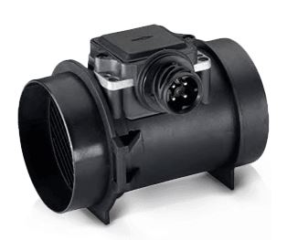

It's funny you should say that! There was a thread ages ago with a Mito owner saying he couldn't find the MAF, and given they're usually a good 3 to 4 inches in length and inline with the intake pipe with a loom plugged in the side is a bit weird? Have you got access to EPER?
Yes thats what the parts list says and is showing on eper but not the exact location - mind you given the location of the Air Filter it doesn't surprise me!
Will see what my garage say.......... Thanks for the assistance Mikey
Italians hey... Why make something simple when you can over complicate it, and put things in stupid places! :lol:  I wouldn't mind but it's not like we're not used to it with all of the Italian cars we've owned over the years!! ;)  :P
Car left at my mates garage to be looked at when he can...........  I did mention to him about the MAF but apparently the MA unit does not have one like Mikes image above - its all within some kind of throttle pressure valve apparently?!
