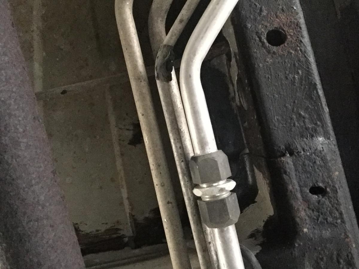

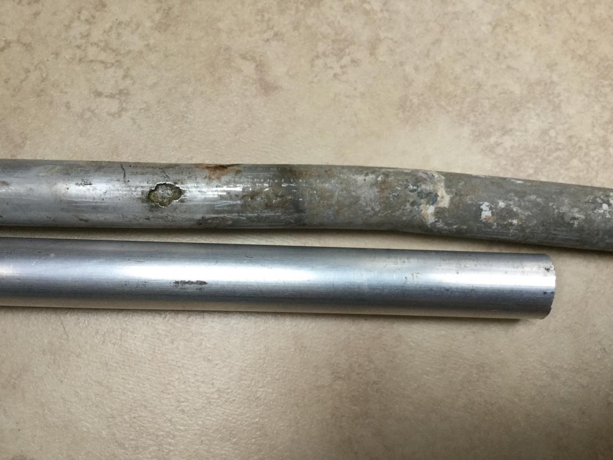

May be a bit late with this but I had the same problem ,one of the two air con pipes to the rear unit was leaking , water gets under the plastic coating of the pipe and it rots.i got a piece of pipe from e bay (19mm) and 2 splice lok fittings from direct supply and cut the old rotten pipe out and repaired it .it was a reasonably easy job to dopost-2665-0-04321100-1532680063_thumb.jpg

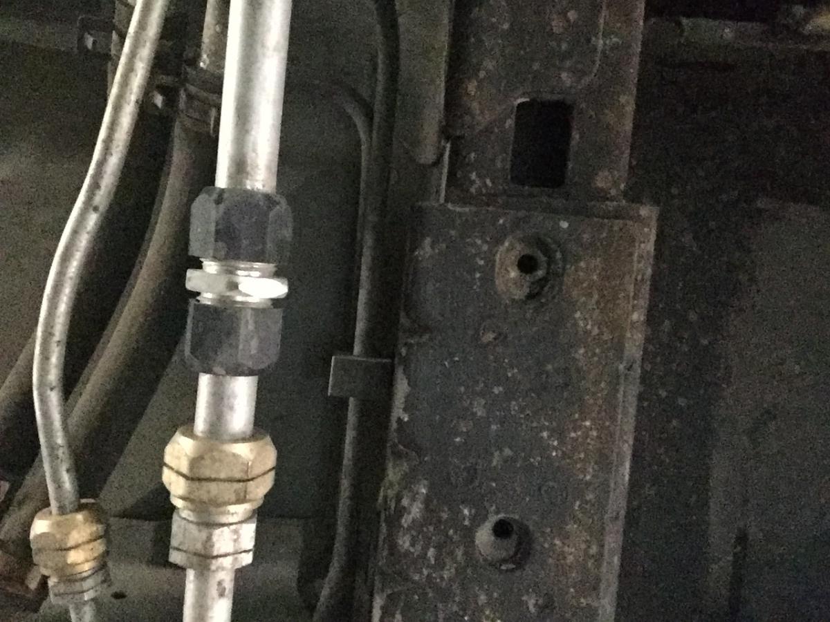

Hi big nev hope you managed the search ,I don’t know how to attach a link but if you search for “ direct supply uk “ and on their site search for “ splice lok “ it’ll take you straight to them I’ll try to post a picture of the finished job later . Cheers Frank.
Hi big nev I’ve been trying to post on here but it says I have but I can’t see it ,don’t know if you can.
Any way I’ll try again,I’ve added two pictures of the splice lok fittings I put on 3 yrs ago and they still hold the gas , if you google direct supply uk and search for splice lok it takes you straight there they are not cheap but it’s cheaper than all the pipes and a damn site easier

£26.34 each in stock, plus a few quid for a piece of pipe must be the best way to go.
