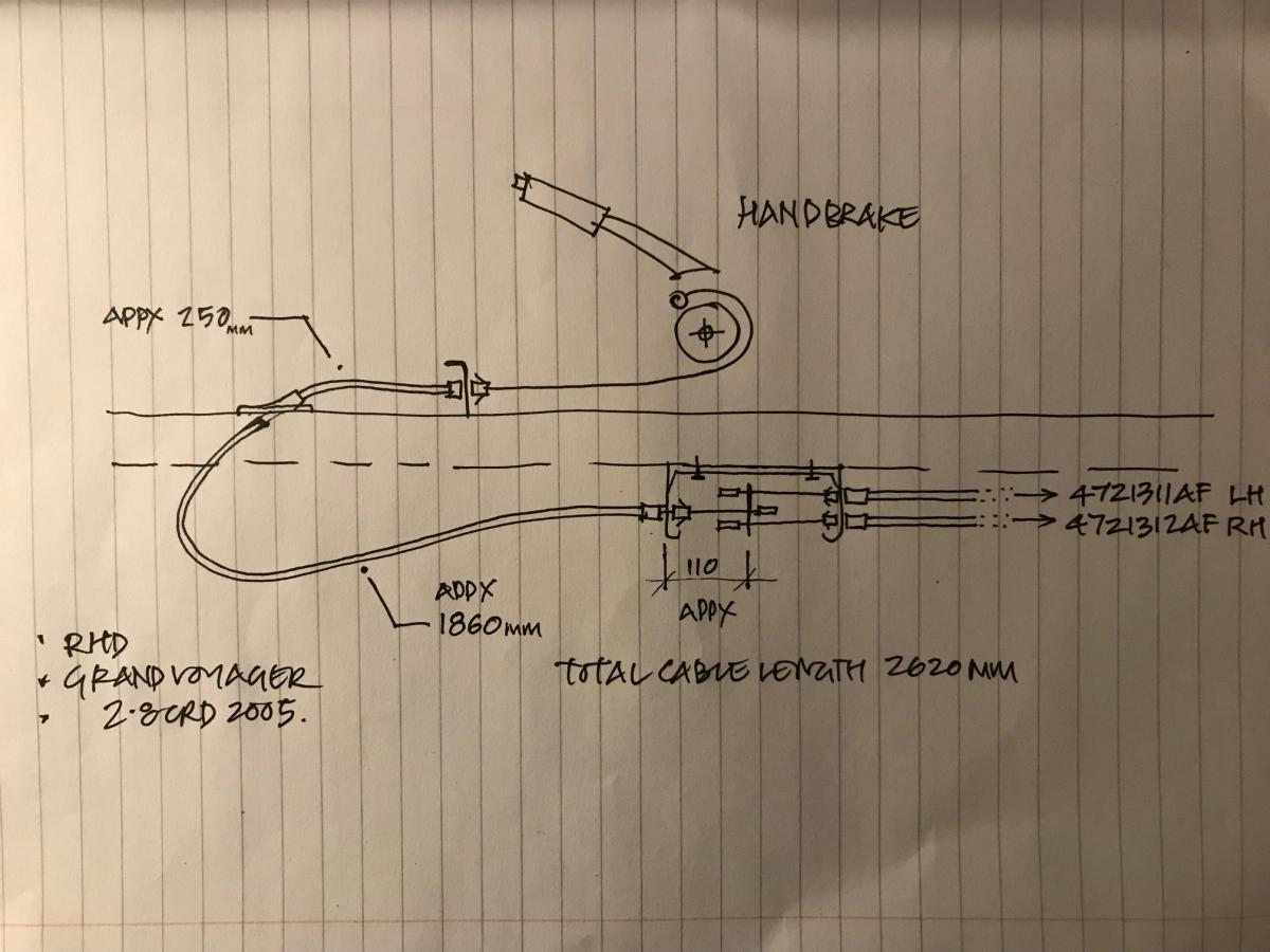

Hi Folks,
New to the forum but a long time Chrysler owner
Having a few issues with the right part re front parking brake cable as per below and would be grateful for your help / advice.
For context please note the following;
  • Chrysler GV 2.8CRD, RHD 2005, stow n go.
  • As such vehicle has front and two rear cables (ie no intermediate cable)
  • After some research (including this thread), part number for front cable is 04721246AC
  • This has also been confirmed by dealer after taking the VIN number and reg and checking against their database.

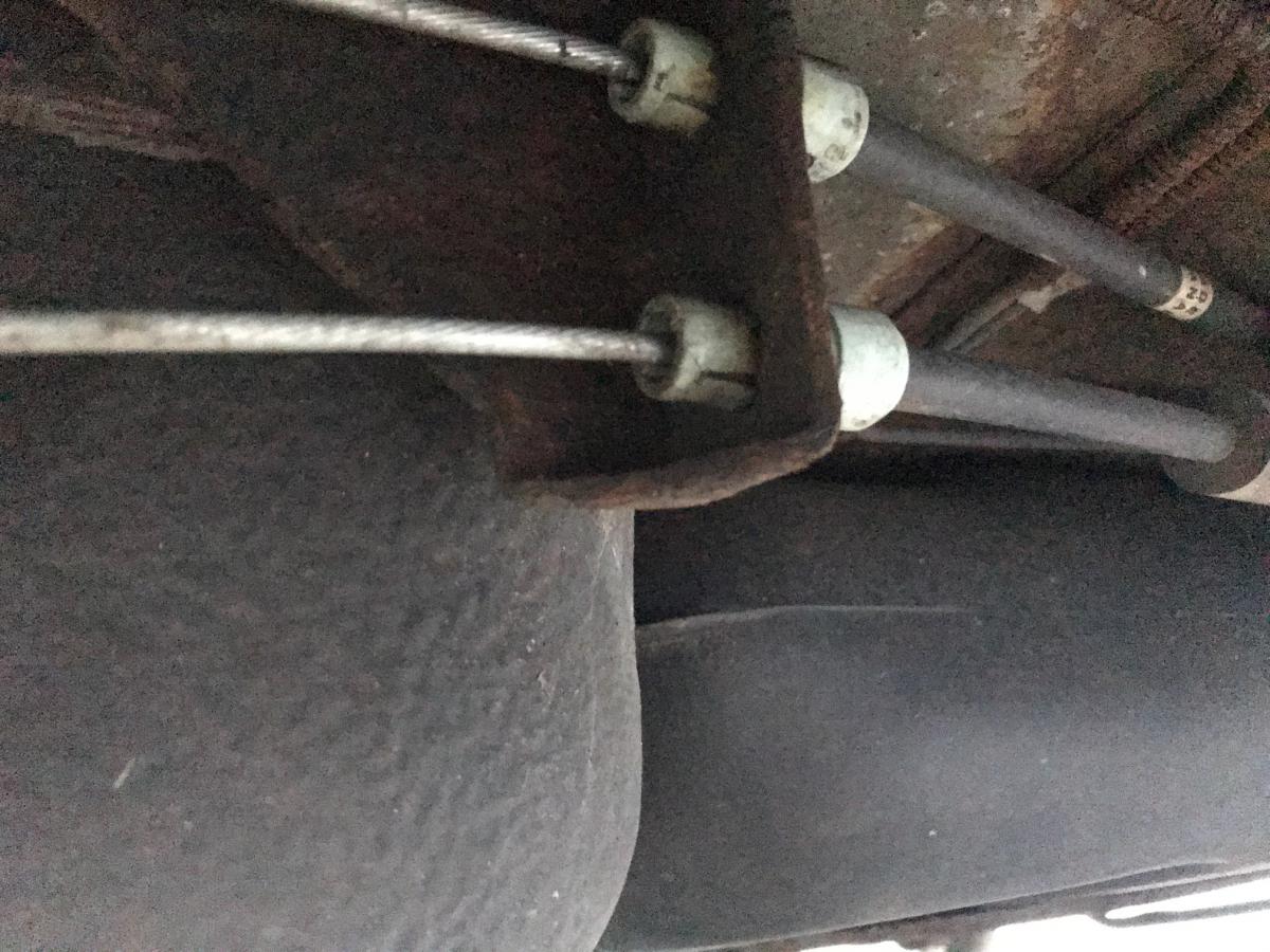

  • Rear two part numbers are 0472311AF and 0472312AF

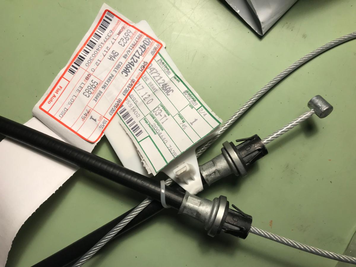

  • The issue is that the actual / original front cable measures 262cm (as per above) but the new replacement part received is 192cm or thereabouts.
  • Was just over 70 quid from main dealer (albeit not directly for Chrysler now)
  • Unless the part received has been wrongly tagged (strange really, but may be just sod’s law!), the part …1246AC is not a correct fit for my vehicle.

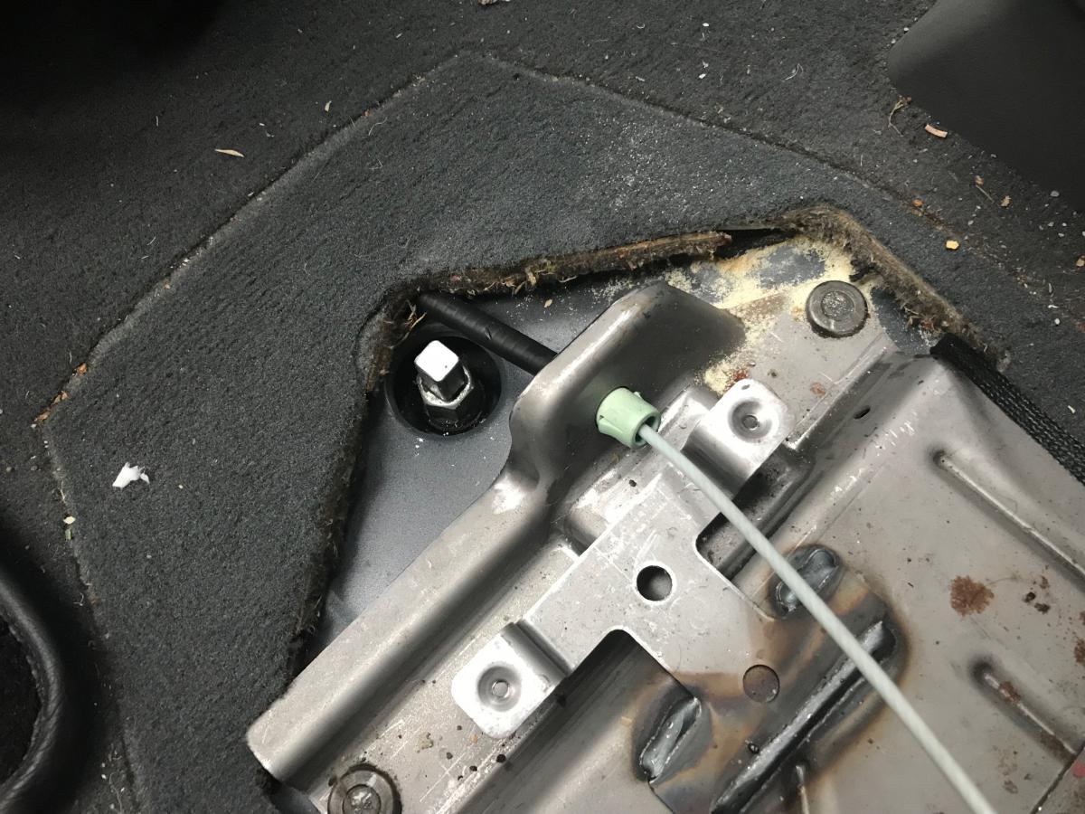

  • The original cable has the green ends with the tabs for a push fit into the brackets in the cabin and underside (same as the non-wheel end of the rear cables) - however the received part has metal ones.
  • All being said the black sheathed part of the cable is no way going to stretch from the lower bracket to the upper bracket, so is definitely the wrong part.
  • Have searched part numbers galore so am hoping a mistake on the tagger!
Any ideas folks – many thanks
