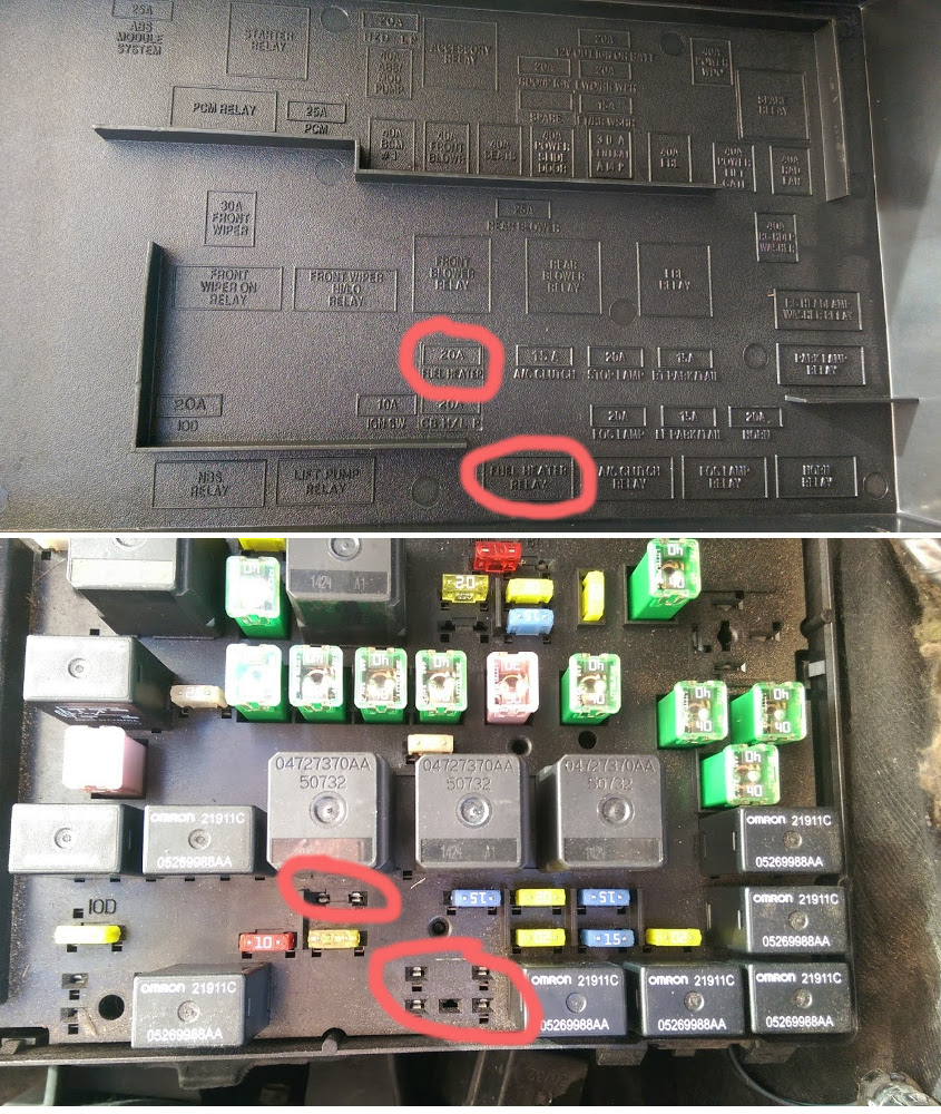

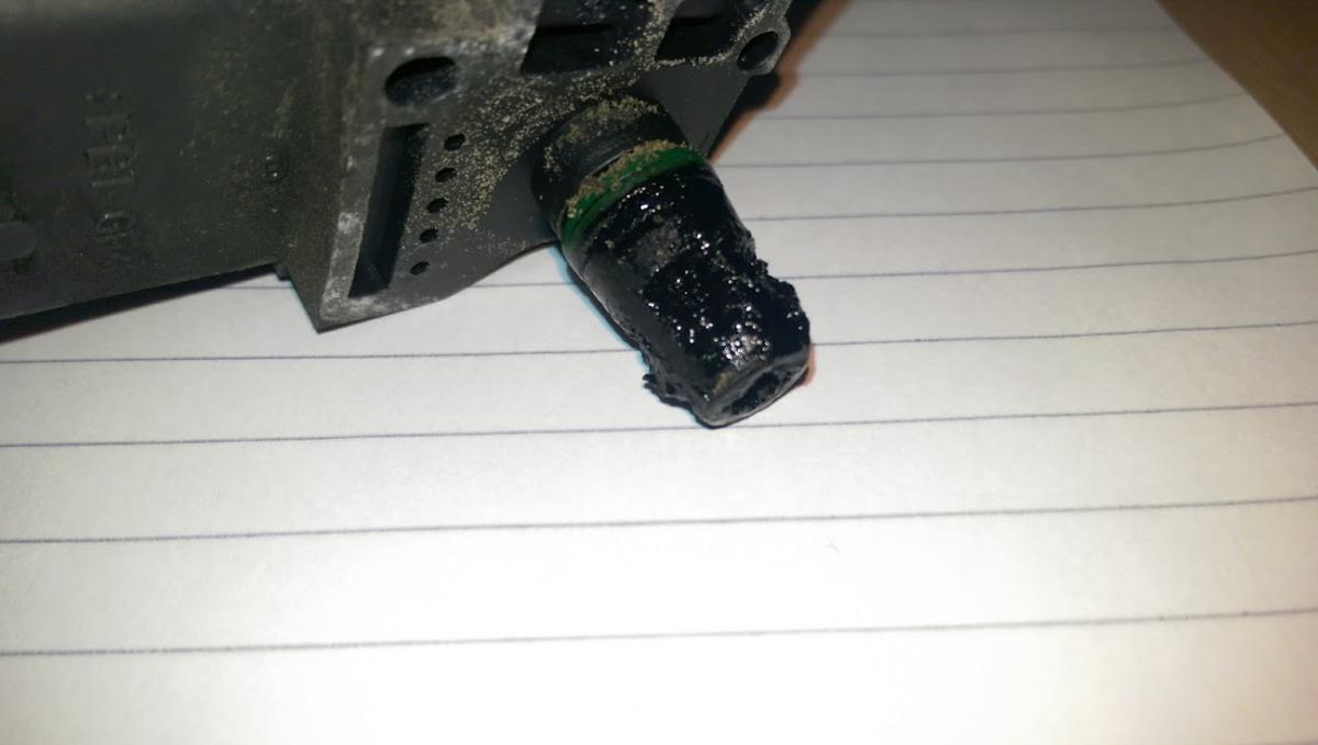

Well, this gets stranger perhaps, so bear with me!
After getting it home, starting to think through it all again, as was about to change the filter @mikebh8 as I was thinking the same, gunk in there, building up over time, so swap/clear it out again.
Then I thought, this is temperature related. Cold weather every time. So looked at what is temperature linked. Diesel fuel heater, which is inside the filter assembly. Shop manual states it operates at 8oC and lower and will run fuel temperature up to 25oC. So that would/should be running helping the fuel atomise (General google search confirms that all diesels have this and symptoms of failure are exactly this, cold weather start and random cut out).
So went to check the fuse and relay first... MISSING from fusebox.
So I borrowed a relay and fuse, ignition on and the 20amp fuse blew straight away, so we've got a short. So, went under car and disconnected the connector block (6-way to the fuel assembly, carrying the lift pump power, water-in-fuel sensor and the fuel heater). Tried again, blew fuse again, so I now know it's actually a wiring fault/short to ground somewhere between the IPM and the connector at the fuel filter housing.
So that's the next job, find the wiring fault/short causing the problem. Maybe I'm getting somewhere, or maybe I'm on a wild goose chase, either way I've got a fault to fix!
If anyone else could do me a favour? If you have a diesel GV, have a look for that fuse and relay, just to confirm they should actually be in there. I'm going to say yes they should since the electrical connections exist, the diagrams show the existence of the heater, etc.
