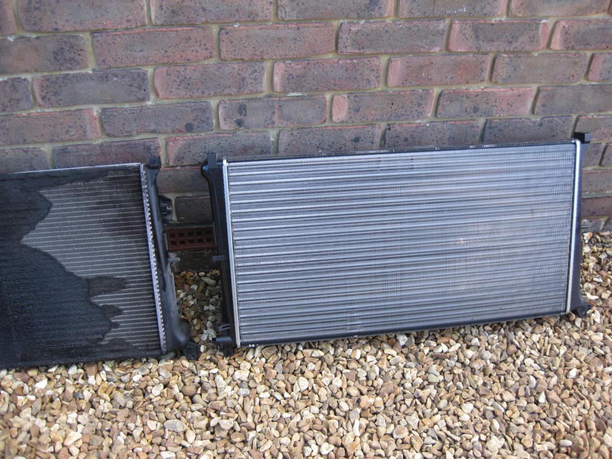

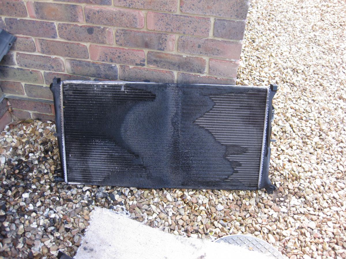

So it was a nice day today, and I finally got the Rad out.
Whoever the Clown was at Chrysler who thought it was a good idea to put steel bolts into steel nuts in-order to hold the Rad in place, but then have those nuts only retained by the plastic around the Rad, which after 13 years had all rusted solid and allowed the nuts to spin in the plastic, making me drill and cut each of them off, doesn't deserve rewarding  :(. It wasn't a 5 minute job  :angry:.
Anyway, the old Rad was half blocked with oily crap, so I'm now optimistic the new one will work better. The other benefit is that the Rad off of eBay must have been wrongly priced as its now for sale at £136.90, and not the £36.90 that I paid  :)
So, which is the new one?? :lol:

A new Thermostat made mine initially run better (presumably by either opening earlier or allowing better flow), but it still built up too much heat. Whereas with the new Radiator it totally solved the problem. Okay, I could have done some sort of flow test to quantify how much more water was going through the new Rad, or maybe it was because mine was also caked in 12 years of thick oily road dirt residue, but once fitted my problems seem to have disappeared :D.
Conclusion is that if you can do it yourself, then it's a worth while fix, but I suspect if it had to go into a Garage and pay mechanics and full part prices, the old girl would be now scrapped  :wacko:
