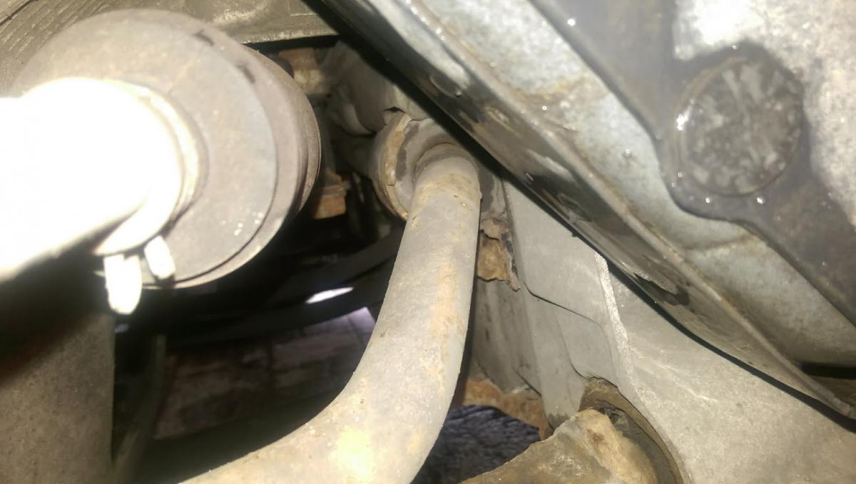

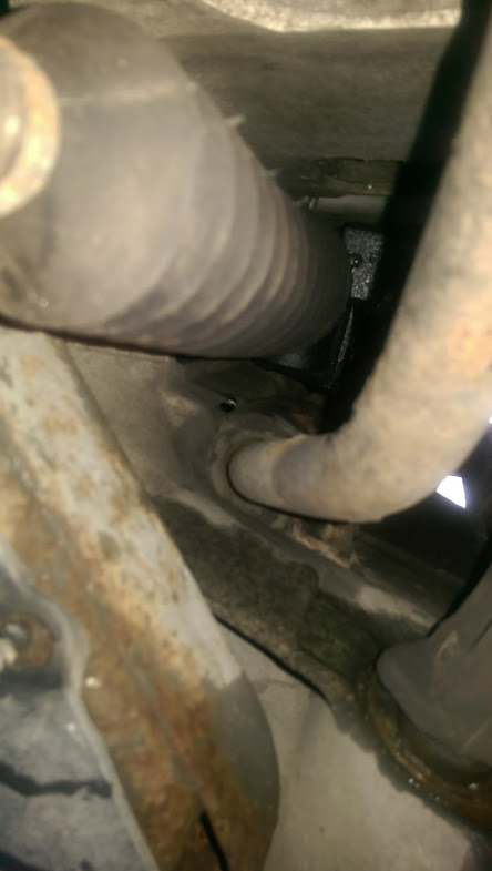

Just a couple of photos that might help illustrate (It's pouring with rain here so not easy to get under to fully show the problem!)
You can see the anti roll bar bush in the photos:
The bolt is at the base, and unfortunately it looks like it's a standard nut and bolt (Rather than a captive nut or bolt so you need to get to both ends). At the rear of that bulkhead that the bolt goes through is the webasto aux heater so can't easily get to it to hold with a socket.
