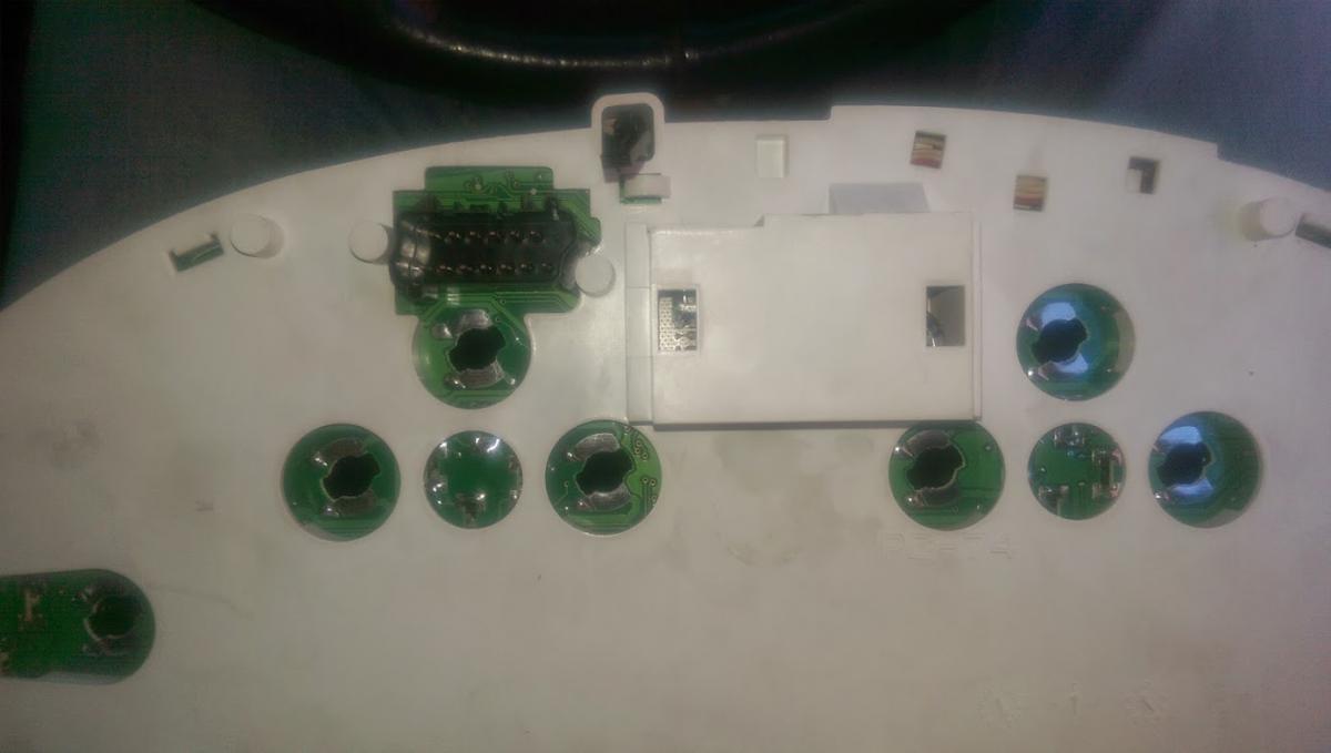

My engine management light comes on with ignition then goes off as it should do but if I do the key dance I have four fault codes but no engine management light on when I bought car the speedo and rev counter wouldn't illuminate removed clocks all bulbs missing can't understand why you would remove all the bulbs unless the clocks I have fitted are the wrong ones any help much appreciated

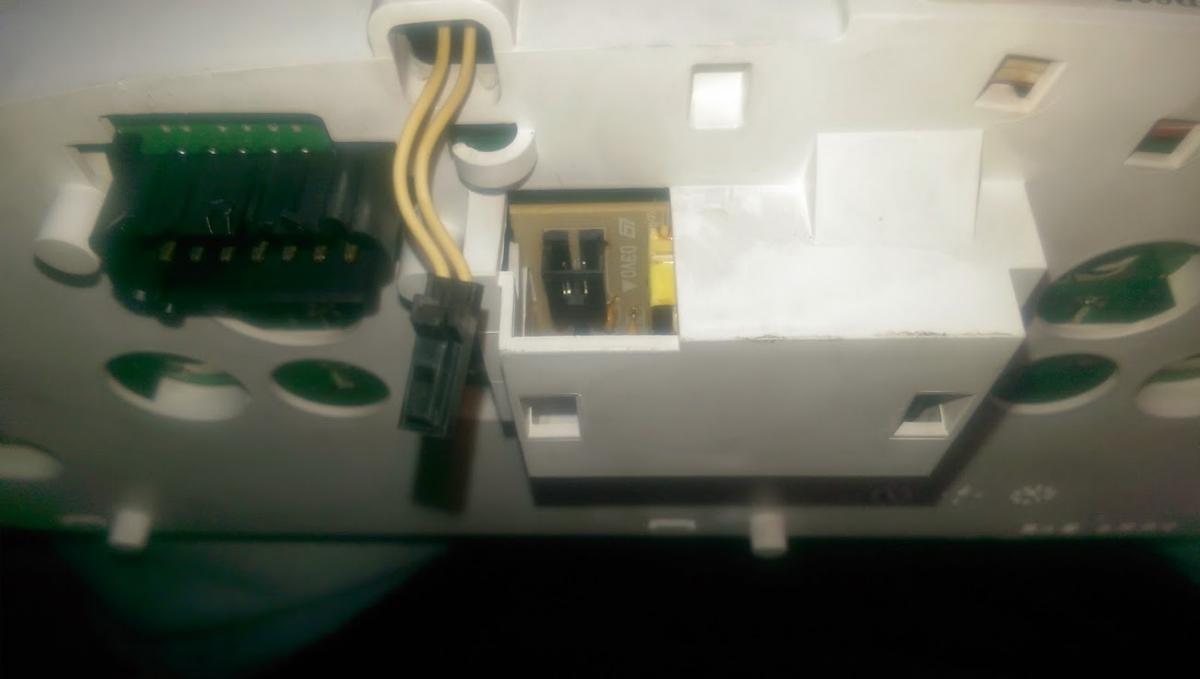

On the speedo and rev counter illumination, this is an oddity, which I also had. The lighting is actually done via el-wire (Electro-luminescent) and all those missing bulbs and holders are CORRECT and shouldn't be populated. Look towards the top at the back of the speed assembly and you'll see a plastic block sticking out, this is the power supply for the el-wire, check the connector there is plugged in, if not plug it in and see if it works.
Here are the photos when I did mine, which sounds the same as yours, look for the connector you can see in the second photo.
